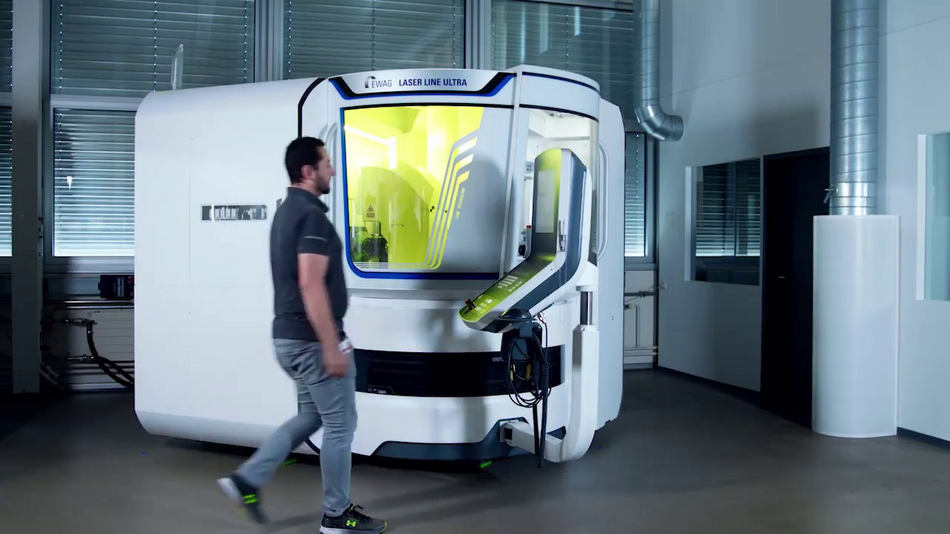

LASER LINE ULTRA
The LASER LINE ULTRA handles all common cutting materials such as carbide, CBN, ceramic, PCD, CVD-D, and MKD in remarkable quality and finish grades. With clamping options up to 200 mm in diameter and up to 250 mm in length, it is very versatile in its potential applications and the first choice when maximum application flexibility is required.
Features
Mechanical layout
The machine bed is made of gray cast iron, providing high stability and excellent vibration damping.
Linear drive
The LASER LINE ULTRA has linear drives on the X, Y and Z axes. The water-cooled direct drives can reach a maximum speed of 15 m/min.
Glass scales
The integrated glass scales provide a linear resolution of 0.0001 mm, promoting extremely high positioning accuracy.
  • Fully automatic loading using FANUC 6 axes robots with 24 HSK63 slots for rotary tools, as well as a pallet system for indexable inserts.
  • A conveyor-driven stacker extends pallet capacity up to 8 pallets.
  • Unchucked rotary tools can be inserted by means of hydraulic tensioning teeth.
  • Hydrodynamic clamping station to accommodate rotating tools.
  • 3D measuring probe for precise positioning and automatic correction of solder errors on indexable inserts.
  • High-dynamic C axis with integrated HSK63 tool clamping.
  • Automatic clamping station for indexable inserts.
