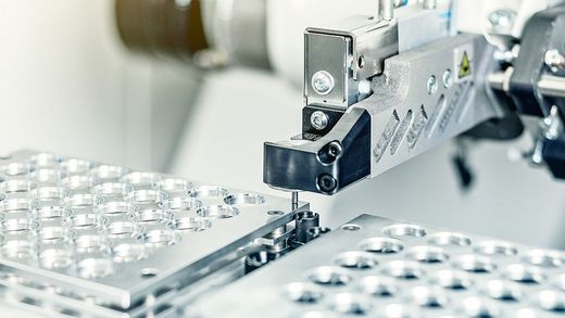

According to calculations based on data from the Robotics Industries Association, installing a single flexLoad system from UNITED GRINDING North America and basic tooling instead of hiring an operator will save you more than $1.5 million in labor costs and nearly $500,000 in productivity savings over 15 years.
Automation solutions have more predictable outcomes and produce higher quality on a more consistent basis, which helps manufacturers optimize HMLV production, even when that mix must be managed by one machine.
Technical Applications
Misconceptions: Robotic loaders are difficult to integrate with cylindrical grinders; and robots are not flexible.
Realities: Integration was more challenging when OEMs were more siloed and focused on specific processes and operations. OEMs such as UNITED GRINDING North America and FANUC have for some time produced built-in automation interfaces, largely eliminating the need for complicated integration efforts. For example, STUDER grinders are engineered for automation.
FANUC controls often enable manufacturers to link their automation with ERP, SCM and MES software, further enhancing OEE.
Furthermore, robotic manufacturing capabilities have greatly expanded in recent years to include 3D vision sensors, adaptive grippers powered by machine learning algorithms, fixtureless designs, and automatic tool changers.
Implementation, Integration and Support
Misconceptions: Automation is complex to program and operate; and it requires a lot of training and support.
Realities: UNITED GRINDING’s consultative design and implementation approach has yielded easy-to-use HMIs and controls. A menu-guided teaching program and a hand-held pendant make it possible for operators without any programming experience to easily set up robots and create new automation routines. Part numbers, grinding programs, home programs, drawer selection and cycle status are all easily accessible.
